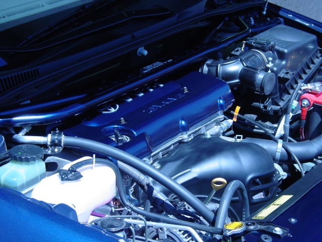

What the heck is that thingy, I think it whistles at 3000 rpm......

That's just a air resonator box... it doesn't really do anything except make the engine quieter really.
And the whistling sound you hear is actually the cams, almost all Toyotas make that "whistling" sound.
The cams? Who told you that? Cams can't whistle. If they do you have a serious oiling problem and the engine isn't long for this world.

Several WRX, Honda, and Toyota enthusiasts actually... I first believed them to be the valve's but *shrug*
They don't know what they're talking about. Whistling is a caused by air moving through the intake. Throttlebodies can whistle very nicely. If you'd worked on carburetted engines, you'd have heard this yourself. Certain geometries in an intake will cause whistling, although most manufacturers try to minimize this to meet Federal noise standards.
DOHC engines don't make much cam noise of any kind, especially when the adjustment is built into the bucket as is the 2AZ. The noisiest thing in a DOHC engine is the cam drive, not the cams.
i've been wondering about that box forever... i could only assume it was a sound deadening device. it has no hoses or wires going in/out... it's just a tumor on the intake

Actually, resonance can effect performance. Mazda/ford used a variable resonance intake system (VRIS) on the KL-xx engines. I think porche used a similar setup at one time.
Usually the variable systems have some kind of valve to actuate them. The one on our cars is likely for noise reduction. I removed mine sometime ago and have noticed no difference in performance. Admittedly, I haven't done any timed tests to see if there is a small difference or not, but I know for sure that box acts as a heat sink, that's why I didn't want it on my car.
what benefits can be achieved by removing it Lance? And how would you remove it without creating a large hole?
Dr. Isotope posted about this a long time ago. He took his off after seeing heat soak sitting at idle (like a red light) that took awhile to go away. I asked him about it, he said he just plugged the hole.
So I was rooting through my toolbox looking for something else, and discovered a 2" rubber stopper (I don't even remember where I got it) that just happened to fit in the hole. I used a conventional hose clamp on it, and I've been without ever since. Actually, I had two stoppers, D has one on his car too now.

So one more time, is there any purpose in removing the resonator box then?
Yes, it adds heat to the intake air when you sit at a traffic light, so you get warm air when you need cold the most.
