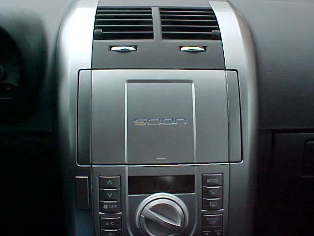

well i finally broke down and bought the Eclipse AVN5435 for my car yesterday. i installed it last night and i absolutly love it. great picture, great sound. i love the fact that it comes with 3 novels to teach you how to use it...lol.
only thing that sucks is im going to have to cut the back side of the door out so i can close it to hide my new baby.
1 - 9 of 9 Posts
just drill holes in the original mounting brackets where the dimples in the brackets are. That will make it mount a little farther away from the door and allows it to close
i was thinking about doing that but instead i took the door completely apart. on the backside of the door it has 3 screws holding the front and back together along with 2 screws on the front.
i just took the good old handy dandy dremel out and cut a straight line under the 3 screws to cut the back panel of the door off. now it works beautifully.
thanks for the help though.
