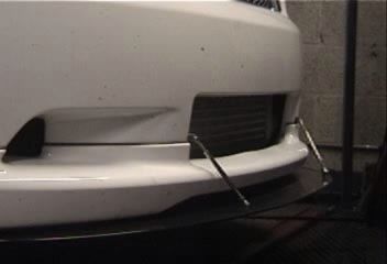

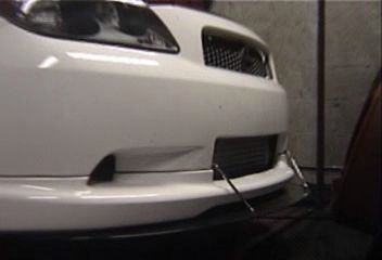

hey guys i was just wondering what that thing is called that is hanging from the lip kit cuz i need it!!! here are some pics

Front Lip Diffuser... some times also called Splitter...
If you think it will help when going down drive ways you will rip that up first, especially carbon fiber / dry carbon ones...
They help with down force on the track, but look cool too...
They can easly be custom made, but some company's make them in Carbon Fiber and or Aluminum...

It's an Air Splitter but you'll just waste about $200-$300

If that's a splitter, I'll eat my bodykit. This is a splitter. Not some wire looking thing hanging down from the front lip.

My bad, I couldn't see anything attached to the rods even with brightness peaked on my monitor. I see what you're talking about Tchi, thanks for the much clearer pics.
While it might protect the underside of the bumper, those rods are going to transfer the hit to their mount points. I think I'd use some aluminum bolts/screws to secure the rods to their mount on the bumper so they'll shear easily instead of breaking something else up higher. Just bring spare bolts with you in case you hit something.
