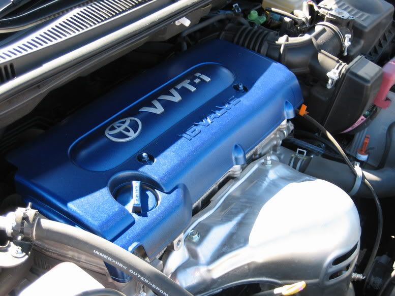

Ill start
Duplicolor Metal Flake - Blue
Duplicolor Plastic Adhesive
Duplicolor Engine Paint - Clear Primer
1 - 20 of 46 Posts
That is cool looking!!
That really is cool looking. Details, please.

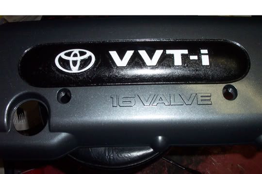

I had just recently did my engine cover also but I am not completely finished with it though.
Remove the Engine cover by unbolting the two bolts which hold it on
Set these bolts aside for later use
Take off Engine Cover
First I masked off the Toyota and VVTI badges
Second Use Duplicolor Adhesion Promoter - 3 Coats
Third- within 10 minutes of applying the Adhesion Promoter Use DupliColor Metal Specks paint ** make sure you get the heat resistant kind* - I Did about 4 coats
Forth- WAIT FOR IT TO DRY!!!!
Fifth- peel back the tape
Sixth- Repeat these steps on the little bolts
Last- put engine cover back on and HAND TIGHTEN the bolts that are now painted
And your done
P.s. most heat resistant paints should work
You don't really nessicarally need the ENGINE paint( 500+) because you are not painting a part that gets really really hot
However, you should still use a heat resistant paint
goodluck I hope this helps
Older pic, but shows the cover pretty well...
