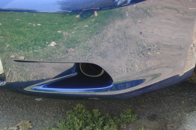

The flexpipe then joins another piece of 2.5" I.D. aluminum, which is fitted to a 2.5" I.D. rubber coupler-- the very kind you find in the plumbing section at Home Depot. That sticks out of the mini-grille hole in the bumper.
And that's my ghetto cold air extension. Combined with capping off the upper resonator (the "heatsoak box") , I reduced cruise IAT by 3-5º, and IAT at idle (heatsoak affected) by about 20º.
